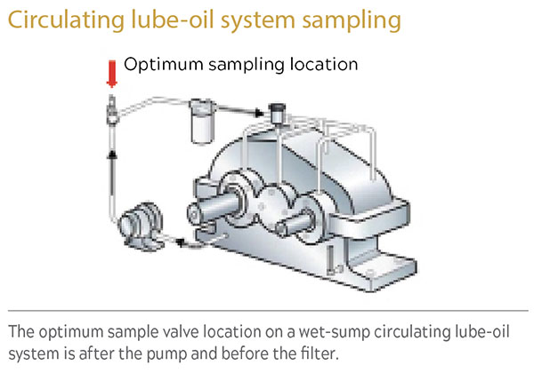

For wet-sump, force-fed oil-circulation systems, extracting a sample becomes easier since the oil is under low pressure. As such, we can use system pressure to extract an oil sample by installing a low-pressure sample valve in the circulating lube lines. For wet-sump circulating systems, the ideal sampling location is after the oil pump and before the oil filter. By locating the sample valve immediately after the oil pump, the sample will pick up evidence of active pump wear, as well as component wear inside the wet sump. While the oil pump may be the least costly and problematic to replace, if it were to fail, the more expensive components inside the wet sump would fail quickly when they become starved of oil. The sample port should always be located upstream of the filter since the filter will remove evidence of active wear and may provide a false sense of security around oil cleanliness.

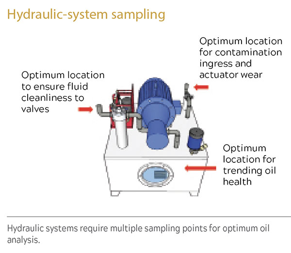

For hydraulic systems, where contamination is often the leading cause of failure, sampling immediately downstream of the most common points of ingression provides the most effective location for contamination monitoring. This allows quick identification of seal failure or internal component wear from the actuators such as cylinders and hydraulic drives. Sampling on the supply line, after the main full-flow filters but before the valve block, may also be desired to ensure that the oil flowing to the most contamination-sensitive components—the valves—can be measured. While this may seem like a lot of samples and additional-oil analysis cost, consider the cost of not taking the sample from the right location and missing a catastrophic failure.
