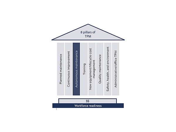

Overall TPM methodology has been adopted by many. However, autonomous maintenance, one of the eight pillars of TPM, has been implemented far less.
The roadblock in North America stems mostly from operators and maintenance personnel working in silos and limiting plant-floor culture/work rules that prevent more operator involvement.
This is changing as many companies move toward starting or enhancing their autonomous maintenance efforts, also called operator-driven reliability. Interest is growing as companies develop operators who can assist maintenance professionals. It’s often stated that operators are the first line of defense against equipment failure. TPM identifies minor stoppages and speed loss (two of the six big losses) as accelerated deterioration of assets. From 15% to 60% of equipment losses have been tied to minor stoppages and speed loss.
