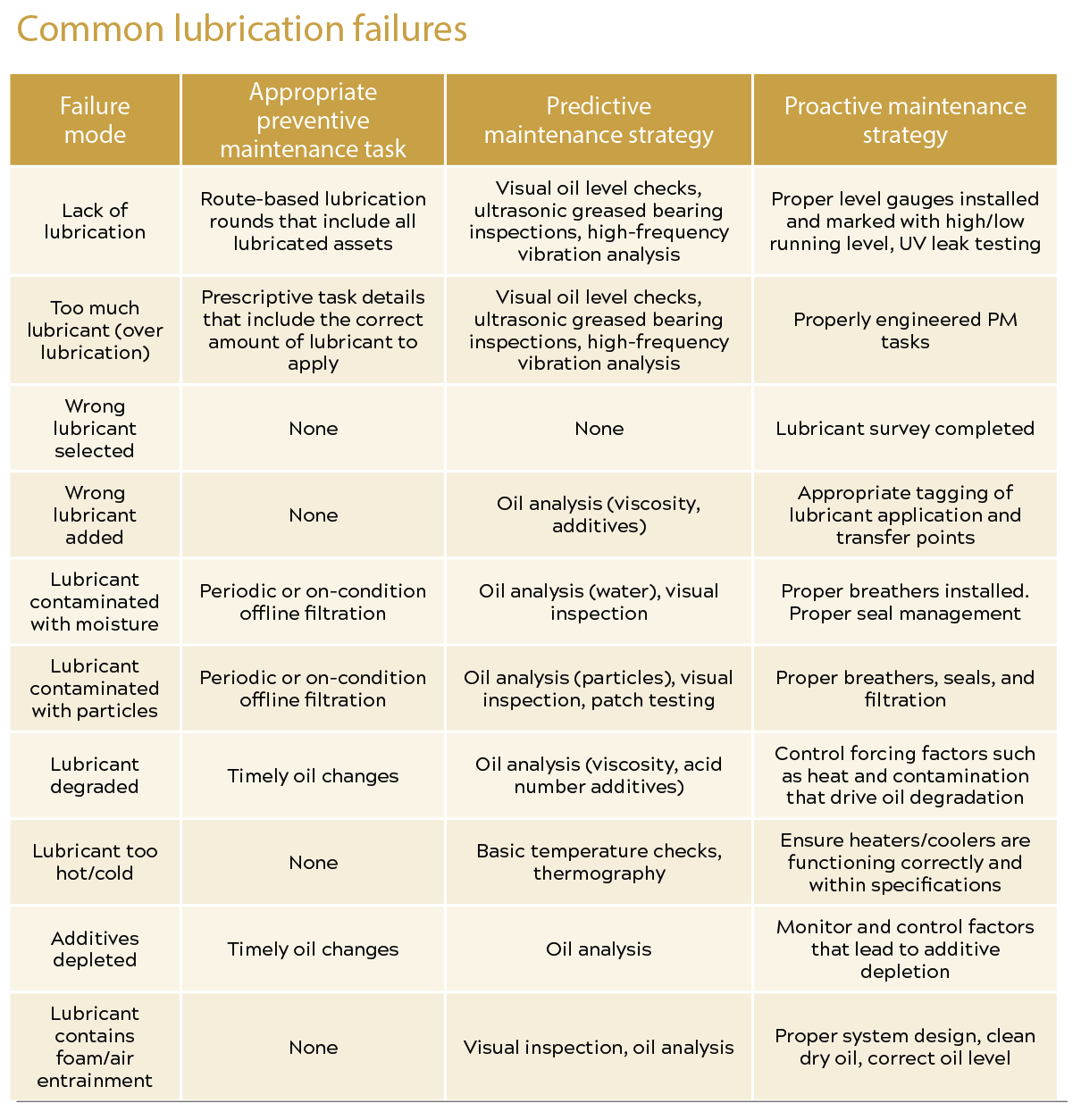

Address these 10 common failures by developing a robust strategy to address each failure mode through appropriate preventive, predictive, and proactive maintenance.
Table 1 shows the 10 most-common lubrication failures, from lack of lubrication to lubricant contamination. While some are more common than others in specific industries, developing a robust strategy to address each failure mode through appropriate preventive, predictive, and proactive maintenance is key.
While applying the strategies listed in Table 1 will undoubtedly drive increased reliability, the reality is that the cost to apply predictive, particularly proactive, strategies to every asset is often cost prohibitive for most organizations. As such, we need to look at not just failures but overall risk.

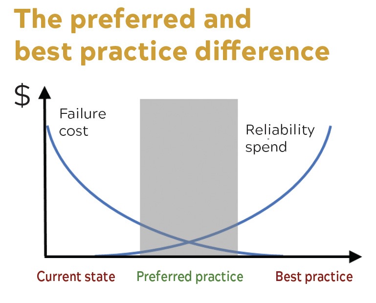

In reliability terms, risk can be defined as the product of probability of failures, multiplied by the consequence. Consequence could include factors such as possible production losses, safety issues, or environmental non-compliance. Whenever an asset is deemed to be at high risk, either because it has a high failure rate or a high consequence of failure, every effort should be made to understand key failure modes and what combination of predictive and proactive strategies offers the best chance of mitigating failure.
Preferred practice is the balance between reduced failure costs and increased maintenance spend.
Key to success is recognizing “preferred practices” (Figure 1). Unlike best practices, which often represent an all but unobtainable level of precision that few organizations can afford to deploy, “preferred practice” is the minimum investment required to achieve a certain reliability objective, without incurring excessive spending over and above the benefits that might be realized through improved lubrication.
By applying a risk-based approach, including the deployment of predictive and proactive measures to deliver “preferred” lubrication practices, companies can achieve effective maintenance cost reduction, while eliminating lubrication-related failure. EP
