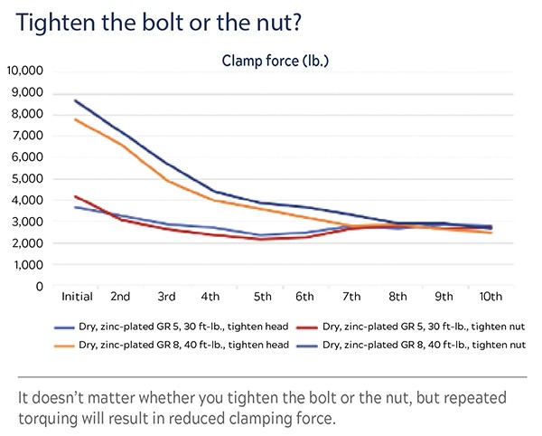

One set of trials was to repeatedly set the torque of dry fasteners first by tightening the nut and then repeat by tightening the bolt. Trials used zinc-plated 3/8-in.-16, Gr 5 and Gr 8 bolts.
It made little difference whether the nut or the bolt head was tightened. Another observation was that repeated torquing of dry fasteners resulted in significant drop in clamping force. After seven uses, Gr 8 settled to no higher clamping force than Gr 5. This was attributed to the higher torque creating additional damage to the sliding surfaces and thus more resistance to the applied torque.

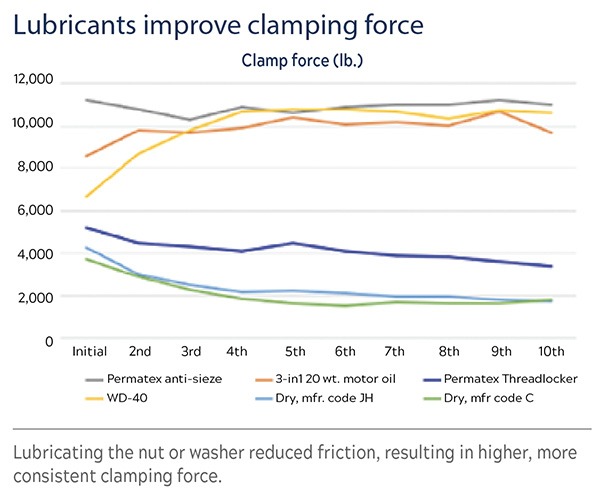

Another series of tests was designed to determine how lubricants affect the clamping force with a repeated torque applied. In this case, GR 8 bolts were used and the same torque applied (37 ft.-lb.), regardless of lubricant. (Most torquing procedures reduce the recommended torque when fasteners are lubricated.) Lubricant was applied to both sides of the washer and to the threads of the nut.
The observation was that most lubricants effectively reduced friction such that much higher and more consistent clamping force was obtained than with dry fasteners. Thread-locking compound did not provide as much lubricating effect.

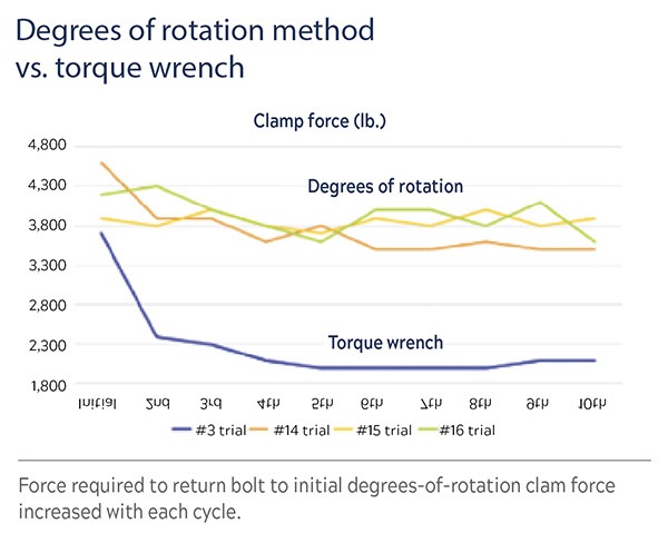

Another test compared the resulting clamping force achieved by the degrees-of-rotation method to that of a torque wrench. In this scenario, the bolt was first torqued to 37 ft.-lb., the degrees-of-rotation noted, then the bolt was loosened and returned to the same degrees nine times. All tightening was performed with dry 3/8-in.-16 zinc-plated Gr 8 fasteners.
Observations were that the amount of force required to return the bolt to the initial degrees increased significantly with each cycle, almost to the point of breaking. Returning the bolt to the original degrees provided repeatable clamping force, but at the risk of breakage.

Lubricating the bolt provides much greater clamping force than dry bolts and tends to have more repeatable results. While the turn-of-the-nut and degrees-of-rotation methods provide more repeatable clamping force, using this method for repeated torque cycles of dry fasteners presents opportunity for failure. The turn-of-the-nut method is a common practice when using new bolts on structural configurations, but the bolts are not to be reused. For this reason, the turn-of-the-nut method is not appropriate for industrial equipment. EP
